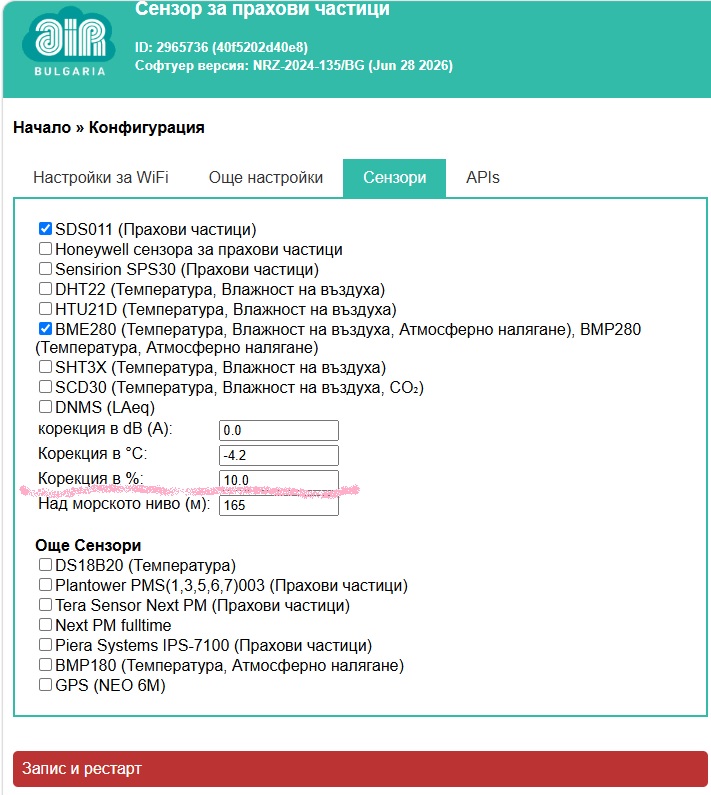

I’m not complaining about the accuracy, but I just would like to have it aligned to the other T&H sensors that I have.
I’ve positioned it close to another sensor in the center of my house, which I used as “master” to correct all the others. In the picture you can see the comparision.
Then, here the request that I think it could be useful for all: similarly to the “correction °C” already available, is it possible to add a RH% correction?
Just to be clear, I’m speaking about this correction, already present for the temperature:
Thank you all again for your amazing work!
I could add something in the beta for now but you will have to flash with platformio.
Thank you pjg… I’ve applied the correction after the acquisition from the web. Then I’ve solved it.
But in any case I think it is something interesting for the future customers.
Thank you again for your amazing work,
Andrea
OK. But I should code again a bit.
I also want to calibrate my bme280. Where is the beta firmware with the humidity calibration/correction? Thanks
OK. i build a firmware myself from github (airrohr-firmware) that supports humidity correction on the bme280.
