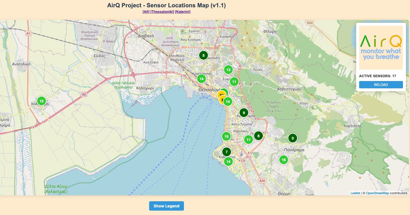

in january 15, i posted this.
i decided to build a sensor network in my city
2 months and 10 days later, with the help of many people from sensor.community, i am proud to present our first map…
keep on sensoring :slight_smile:

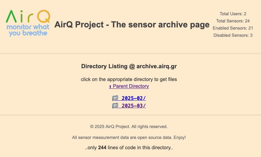

now it is time to organize the archive a little bit..
so, here it is..
