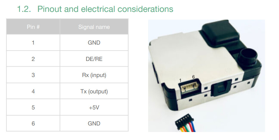

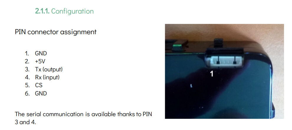

The Tera sensor comes in different versions with different pinouts, so please take care how to connect
Pin 1 (GND) -> GND
Pin 2 (5V) -> VU
Pin 3 (TX)(output) -> (RX) Pin D1 (GPIO5)
Pin 4 (RX)(input) -> (TX) Pin D2 (GPIO4)
Pin 5 (CS or DE/RE) (unconnected)(high impedance)
Pin 6 (GND) -> GND
