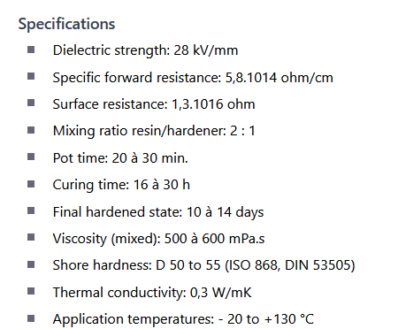

It is the same with the resin. it should be mor or less the same specs:
