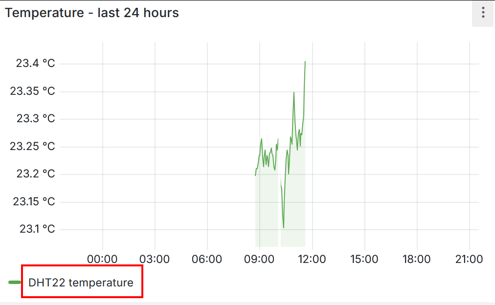

Madavi thinks my sensor is DHT22 - as far as I know, this type doesn’t need prefixes. (Tried with “SHT3x_temperature” and others). Any clues?

BTW. Do you think the sensor in the legend (madavi) can be changed or am I stuck to DHT?

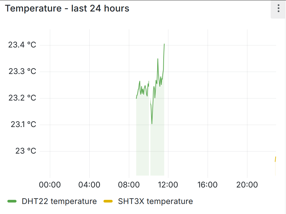

Got it! Thanks for help. I changed 2 things:
  1. Formatting in my json - it shouldn’t change a thing cuz PM data was transmitted with no issues before
  2. Updated data transmission to send values with precision up to two decimal places for temperature and single decimal place for humidity. Before that, I was sending values like “22.9382615”.
My Graph on madavi changed a bit - it answers one of my questions :smiley:
