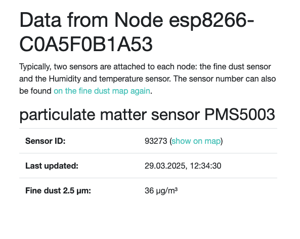

I’ve been sending PM2.5 data from my custom sensor setup since March 26, and it’s already been over 3 days, but the sensor is still not showing up on the Sensor.Community map.

- POST to
https://api.sensor.community/v1/push-sensor-data/ - Headers:
X-Pin: 1X-Sensor: esp8266-C0A5F0B1A53Content-Type: application/json- Payload:
"sensordatavalues": [
{ "value_type": "P2", "value": "17" }
In my dashboard, the sensor ID is 93273. I’ve set the exact coordinates and made them public. The server responds with 201 Created every time, so I assume data is accepted — just not showing up on the map.
Am I missing something? Is there a manual approval delay or extra step?
