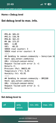

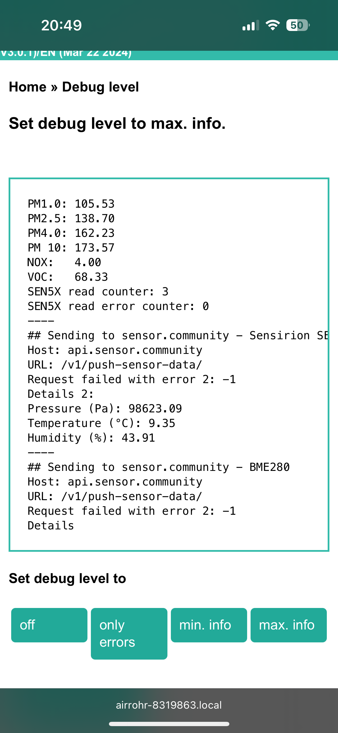

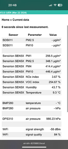

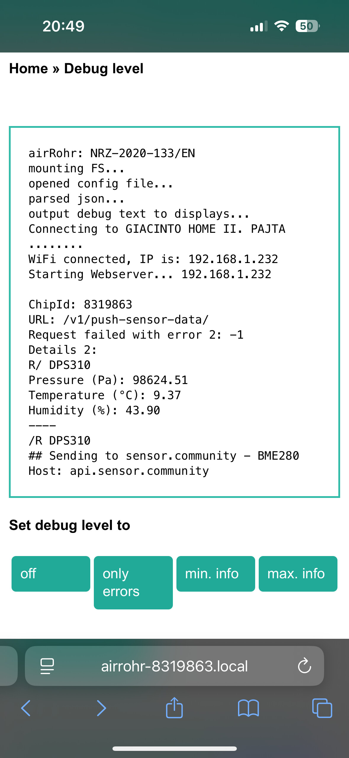

I made it but couldn’t see in the map. I took some pictures.
Although off-topic, where the hell did you place this sensor, next to a chimney or in a smoking bar?
These PM values are insane.
Hello @Nandor_Kiss could you please install the latest firmware version?
All versions before 2024 can’t use https as there was a change in the certificate chain. You may need to install this version manually as the OTA update also uses https.
Well I placed it on the edge of the terrace towards the garden, but the neighbor’s chimney is nearby and, well, this is the countryside and it’s heating season.
It looks like you are using an Iotronic device with modified firmware. Have a look at Sensor data reporting error - #8 by t03apt for a similar issue with that device.
