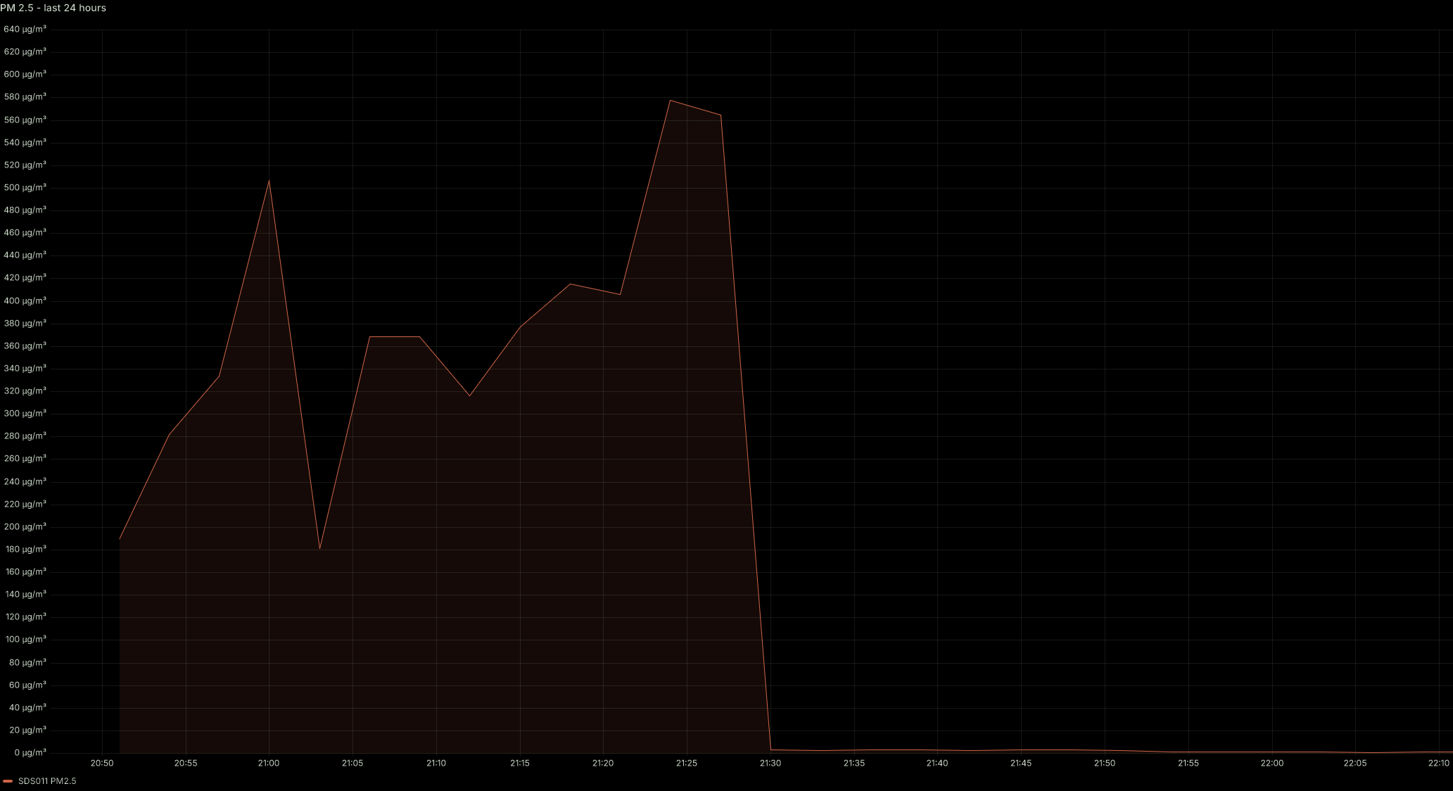

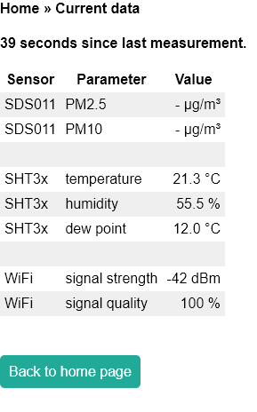

How does one know the sensor needs replacing? Other than it not sending out any data. I ask this because as it turned out, power-cycling (not just doing ‘restart’ via the firmware) made the sensor alive again! It started by sending out ridiculous values at first, then later it turned back to normal. Is this a sign of EOL for the sensor? It has not been updating firmware, and debug log does (did) not show anything of value about this sensor..
