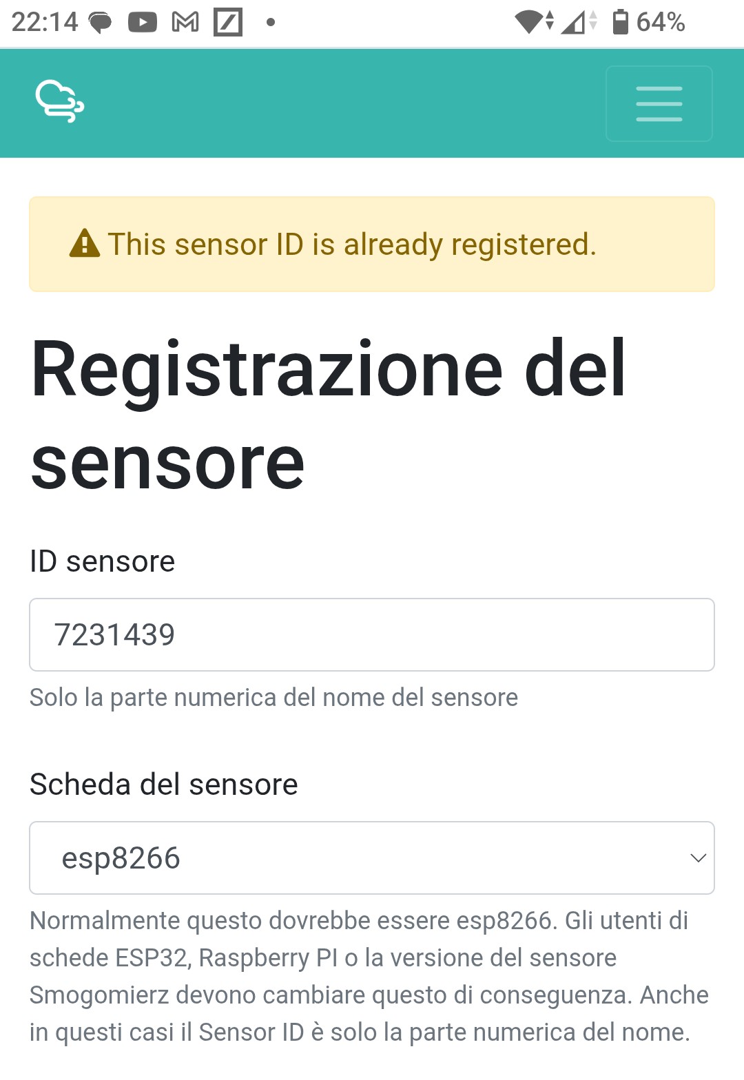

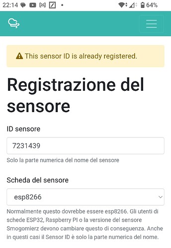

Hi, I’ve had problems with the sensor. I can’t see it on the map. I removed and reinserted the MCU, but it says it’s already in the database. I don’t know what to do. Thanks.
Hello. Following up on my previous post, I’m sharing the error message I get when I try to reinsert my ESP32 MCU board with the sensor.
Hello, I’ve restored the device registration.
Please check, that you’ve selected the right sensors in the local device config and that the sensors are connected correctly.
