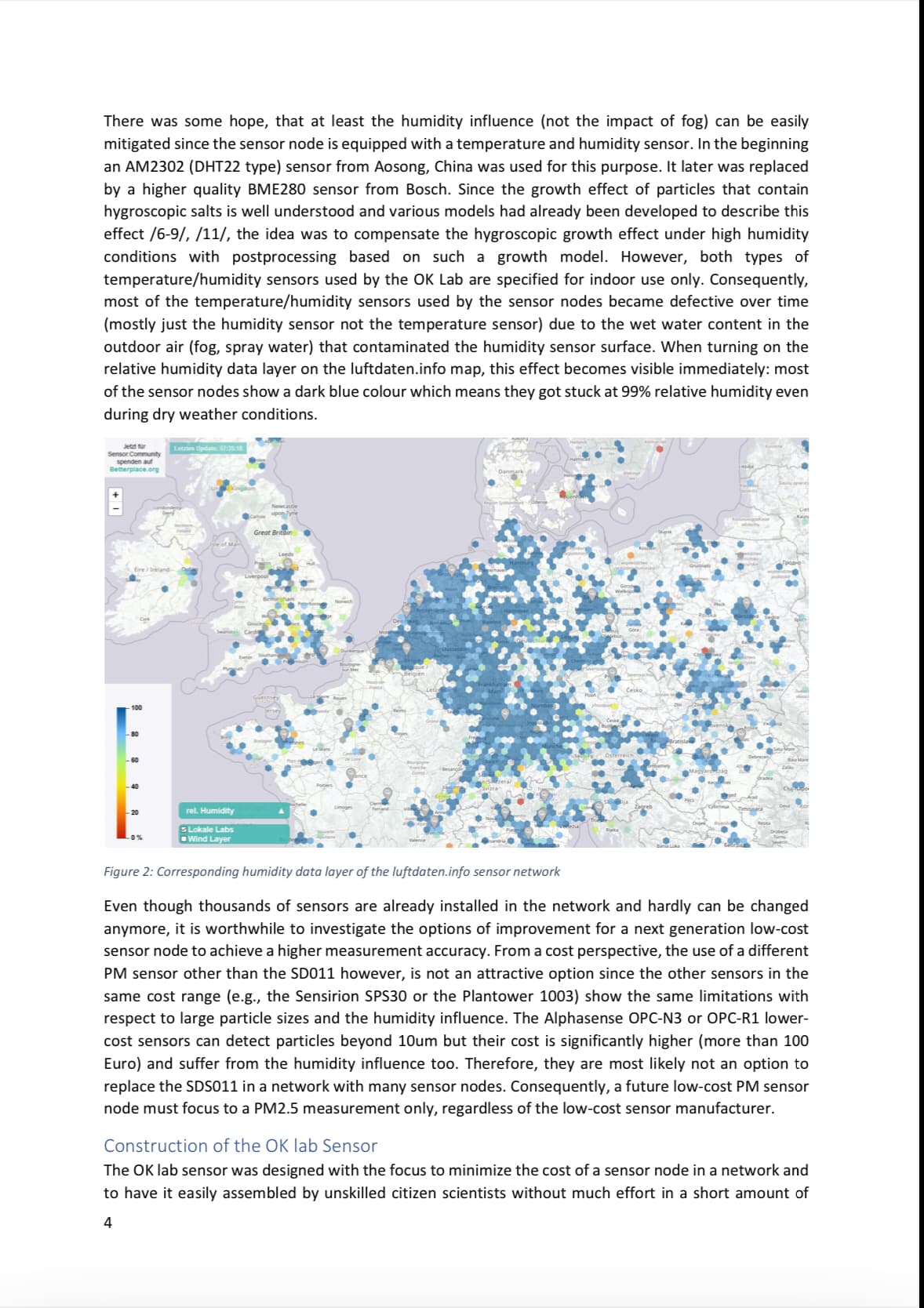

With respect to your other comment about the BME280 not having the same problem I draw you attention to page 4 of the document I linked in my original post (I supply a screen shot for convenience). Perhaps Bulgaria has a lower humidity than some other parts of Europe so the (possible) issue hasn’t been as obvious there?
I am not sure if the linked document has been peer reviewed so I would not necessarily accept all of the comments the author has made but the high humidity readings are undeniable.
The author comments that the BME280 is designed for indoor use (not sure how he has come to this conclusion). This is a surprise to us as it is used in other outdoor systems. It is possible they protect the sensor in some way?
The author also uses an outdoor met sensor HY221 which might be a good replacement but in the U.K. it costs £50.
I think this needs some more consideration and perhaps a phasing out of the BME280s especially in areas of high humidity.
