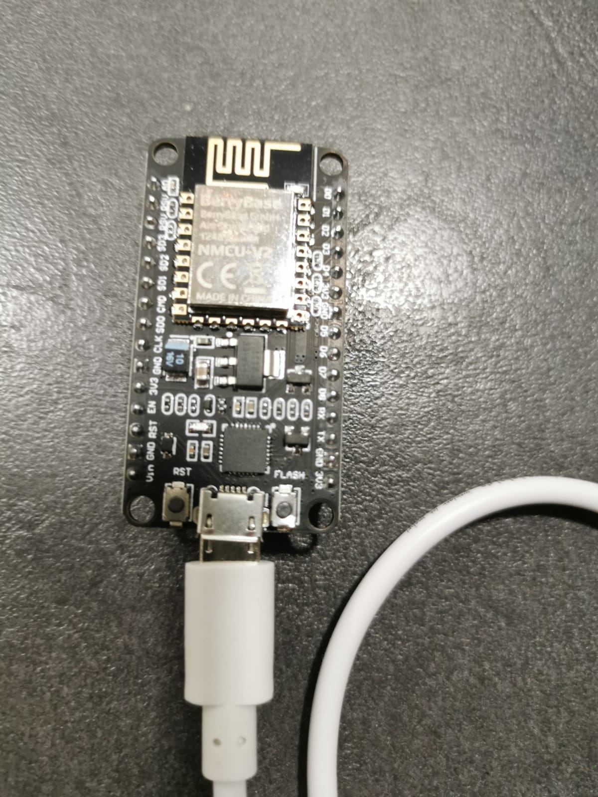

Nodemcu V2 nicht flashbar
Ich habe alles versucht unter verschiedenen Betriebsystemen und mit diversen Usb Kabeln. Habe sogear extra ein superkurzes Datenkabelusb gekauft. Die Fehlermeldung lautet:”Failed to connect to Espressif device: Timeout waiting for packet header”. Auch das Drücken der boot bzw. rst Taste half nicht. Ich bin super ratlos. Auch der Trick mit dem 10 my Elko blieb ohne Erfolg.

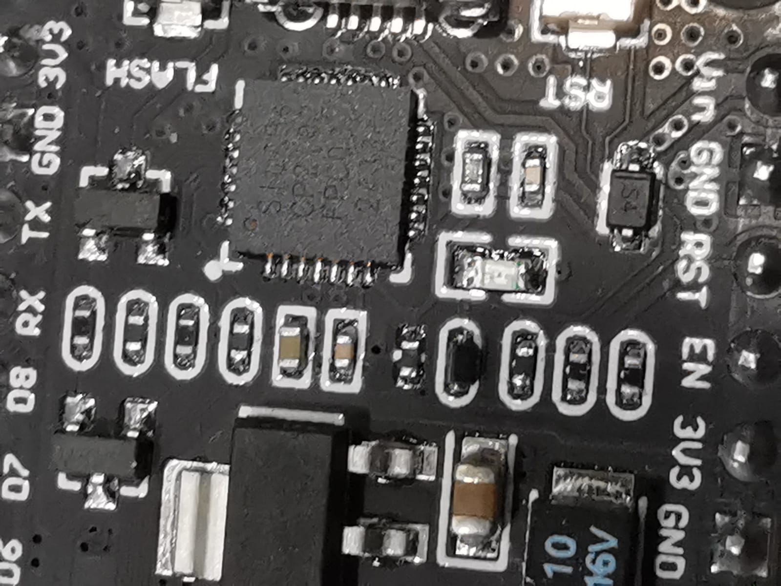

step 1: does the board show up as an extra COM or serial port when you plug it in? If not, check what USB2serial chip it uses and make sure you have the correct driver installed
step 2: use a serial terminal application and open the above COM/serial port, hold the boot button while pressing the reset, and the terminal should show some bootup text and end wait something like ‘waiting for download’
I can remember you had to press the button with the right sequence on the old esp32, but it was years ago.
Do you use the firmware flasher? The esp32 should appear in it if the driver for the COM PORT is installed.
Are you sure you use a data cable? It has nothing to do with the size of the cable.
