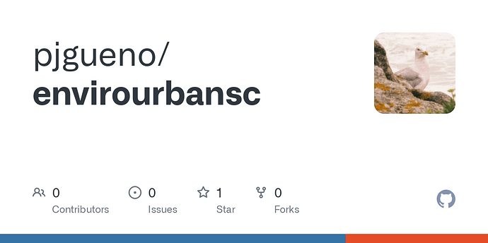

Can someone help me to test this:
As I told to @Toshibaer:
Always ask us before buying exotic stuffs which are not described in our homepage. As we are a community project, we always answer at once not like the commercial websites…
I tried to modify the original code of the Enviro Urban to make it send http POST request the right way for SC.
