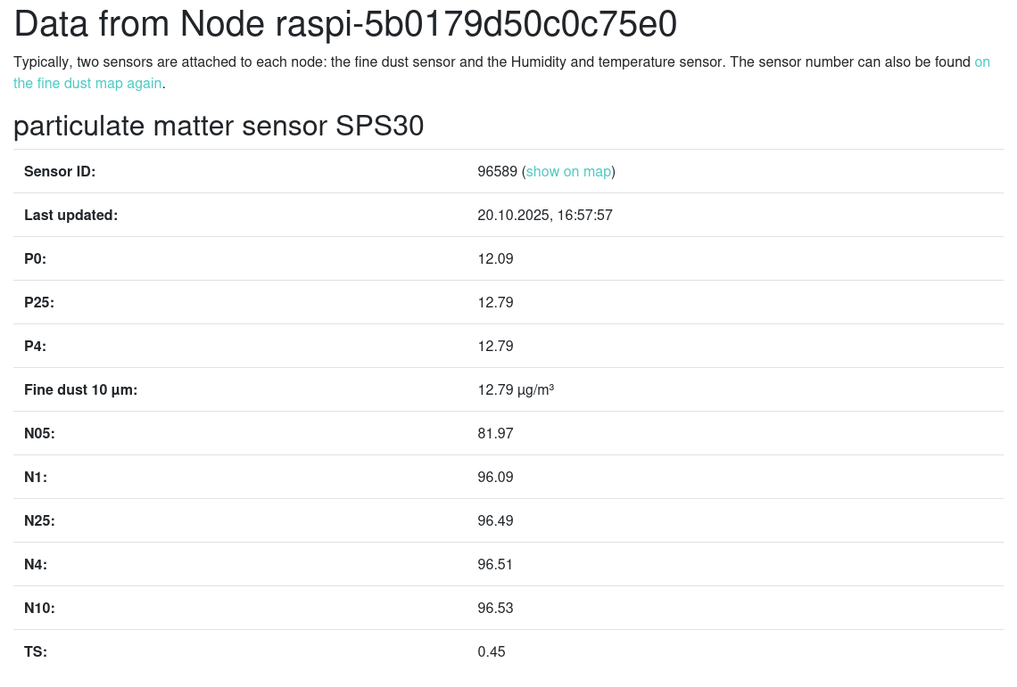

The POST requests succeeds and the data is logged, as can be seen e.g. here https://archive.sensor.community/2025-10-19/2025-10-19_sps30_sensor_96589.csv
I can also see the data updating every minute at https://devices.sensor.community:
However, I still cannot see my sensor as a hexagon on the map when switched to “PM2.5 (5 min. mean)”. I can see a dot at the sensor location when I switch to “Sensors at reference stations”, but no values are shown in that mode either.
What am I doing wrong?

It seems like the P2 (PM2.5) value is missing. Please rename P25 to P2.
We do some checks to filter out invalid sensors, one is the existence of both PM10 and PM2.5 values.
(We named those values more than 10 years ago, as most sensor gave only the PM10 and the PM2.5 values …)
Thanks, that did the trick.
