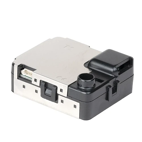

My sensors are more expensive than that but good. The Next PM was/is tested on a large scale by AtmoSud, the official institution for AIr Quality in the south and France and they are happy with it. See project Aircarto.
They are chinese… :slight_smile: and already old.

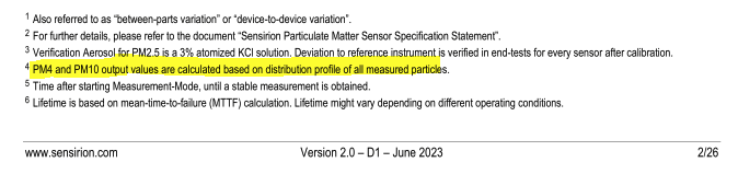

See manual SPS30 (also for SEN5X and SEN6X)
If I remember well the NextPM mesures the different PM Types independently.
The IPS7100 mesures PM1, PM2.5 and PM10 and extrapolate all the other values.
I have to check the datasheets.
I like the NextPM more because there are quite a lot of possible configurations, basic UART and a heating system againt humidity (It can be deactivated if I remember well). And I wrote a beautiful lib myself.
The IPS7100 have also tho advanced features but the way the data is transmited is strange (it is some text…).
Please check datasheets also. You can find them easily on internet.
