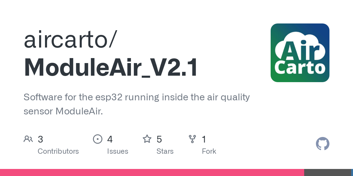

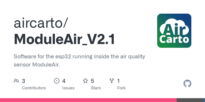

You may use an ESP32 in order to use both UART at the same time or you should program yourself the memory usage on the uC. I have almost pulled all my hair as I tried to understand the semaphores etc. a few months ago. Default ESP32 memory usage can it out of the box. There is example of multiple sensors setups in the Aircarto project.
