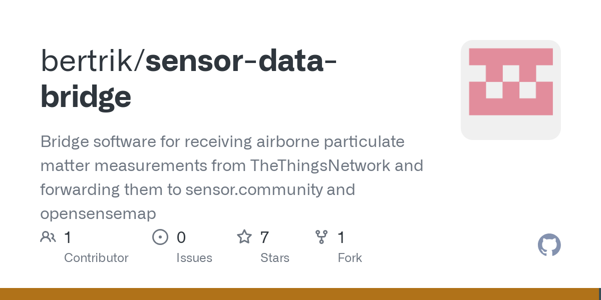

Hi, I created a Java application to forward data from TTN to sensor.community.
The Java application subscribes to the TTN MQTT stream, then transforms the data into a JSON message and sends it with the right headers to sensor.community.
So this is Java, I have not tried to create an ‘HTTP integration’ in TheThingsNetwork console.
Maybe that’s possible too. I wrote my Java application before the ‘new’ v3 version of TheThingsNetwork existed.
My application can be found at
You can configure it to recognise certain fields in the decoded JSON payload as certain measurement items. For example, if you configure “/pm10” as the “PM10”, it will recognise it (and forward it as “P1” towards sensor.community).
I have a plan to make it easy to run this in a docker container, still not got to that point.
