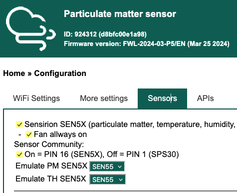

i used firmware FWL-2024-03-P5/EN (Mar 25 2024) but i get excessive readings…
these are my settings…

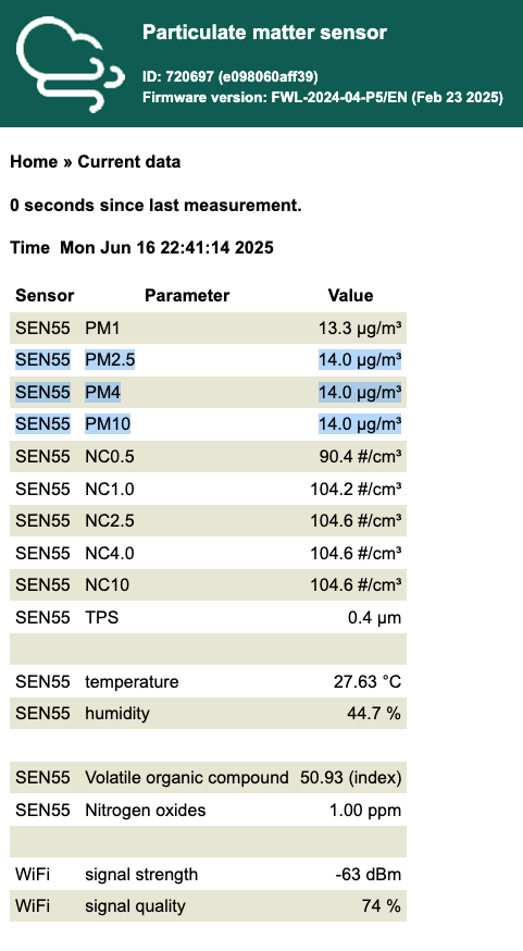

i made a case and put the SEN55 outside once again, after months..
first of all, i noticed that some values are always the same.
for example:
SEN55	PM2.5	14.0 µg/m³
SEN55	PM4	    14.0 µg/m³
SEN55	PM10	14.0 µg/m³

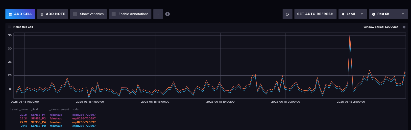

i left it several hours, logging to influx, and the results are the same as you see..
the sensor is not faulty, for sure, its brand new..
this happens to all of you using SEN55 ?

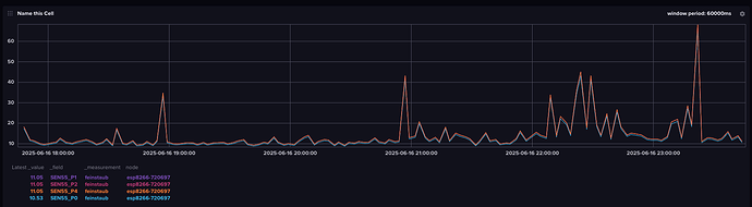

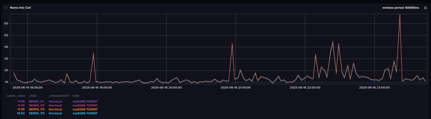

so, what do i keep from these ?
and the values of p0 only differs from others..
