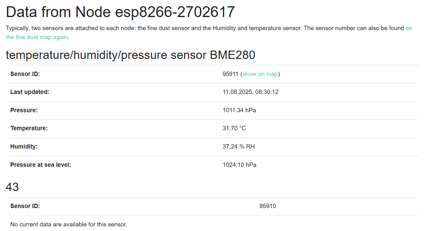

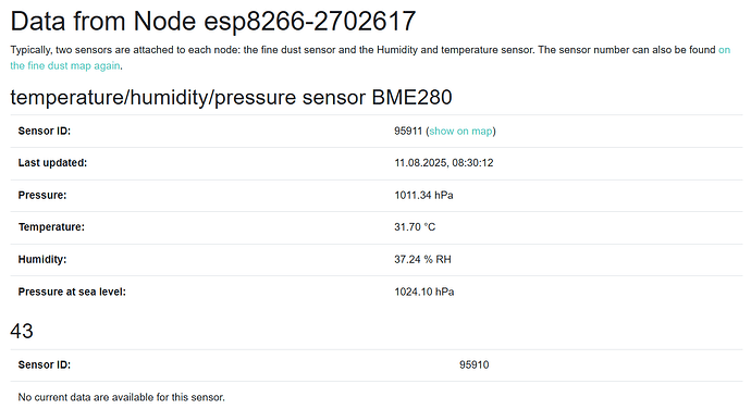

Hi! I have the same problem, my sensor dont visible on the map. Could you help me to configure it properly? Thank you very much!
Iotroniq IOT-AQS3xx/AQS4xx air quality sensor
ID: 2702617 (c4d8d5293d19)
Firmware version: NRZ-2020-133 (iotroniq mod. V3.0.1)/EN (Mar 22 2024)
It looks like your SPS30 isn’t correctly registered. Please check the Hardware configuration section of the Settings page. One Sensor Type should be SPS30, the other BME280.
You were right, I set SPS30 and now works like a charm. Thank you very much for your prompt support! :wink:
