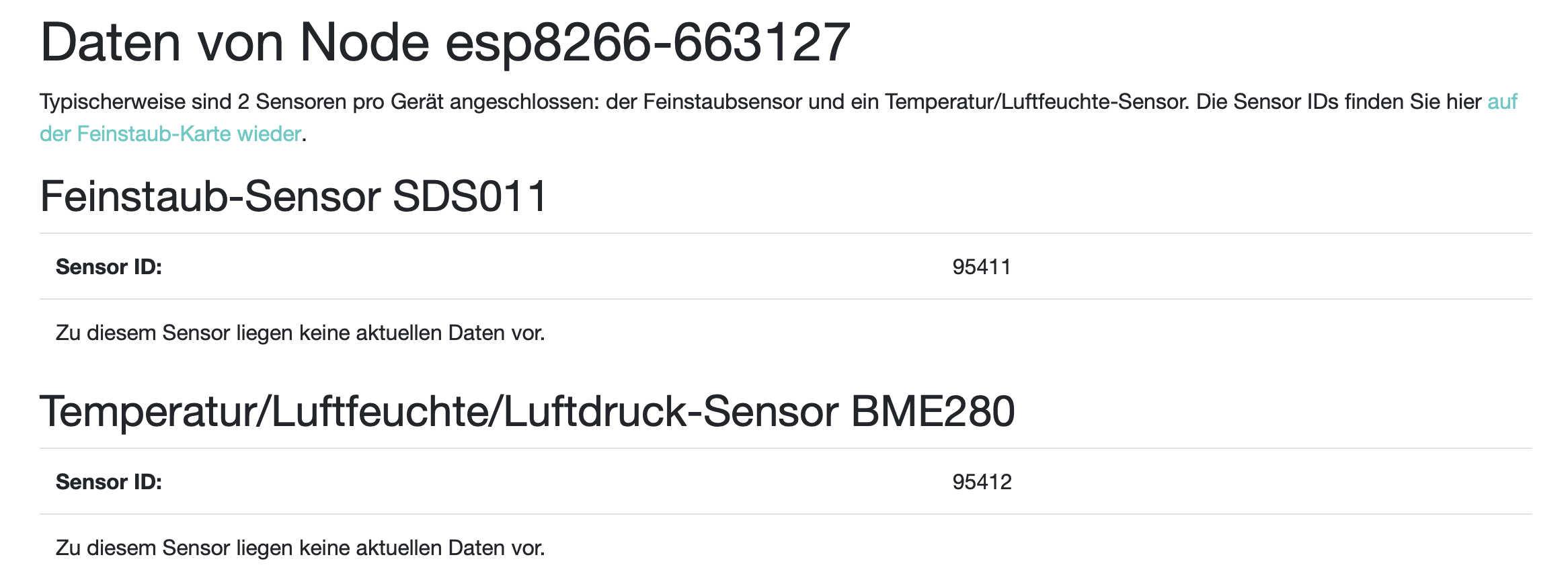

Yes. The Sensor-UID is: esp8266-663127
The two registered Sensors are: 95411(SDS011) and 95412 (BME280)
When I log in to devices.sensor.community it says:
Zu diesem Sensor liegen keine aktuellen Daten vor.

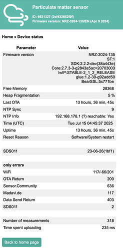

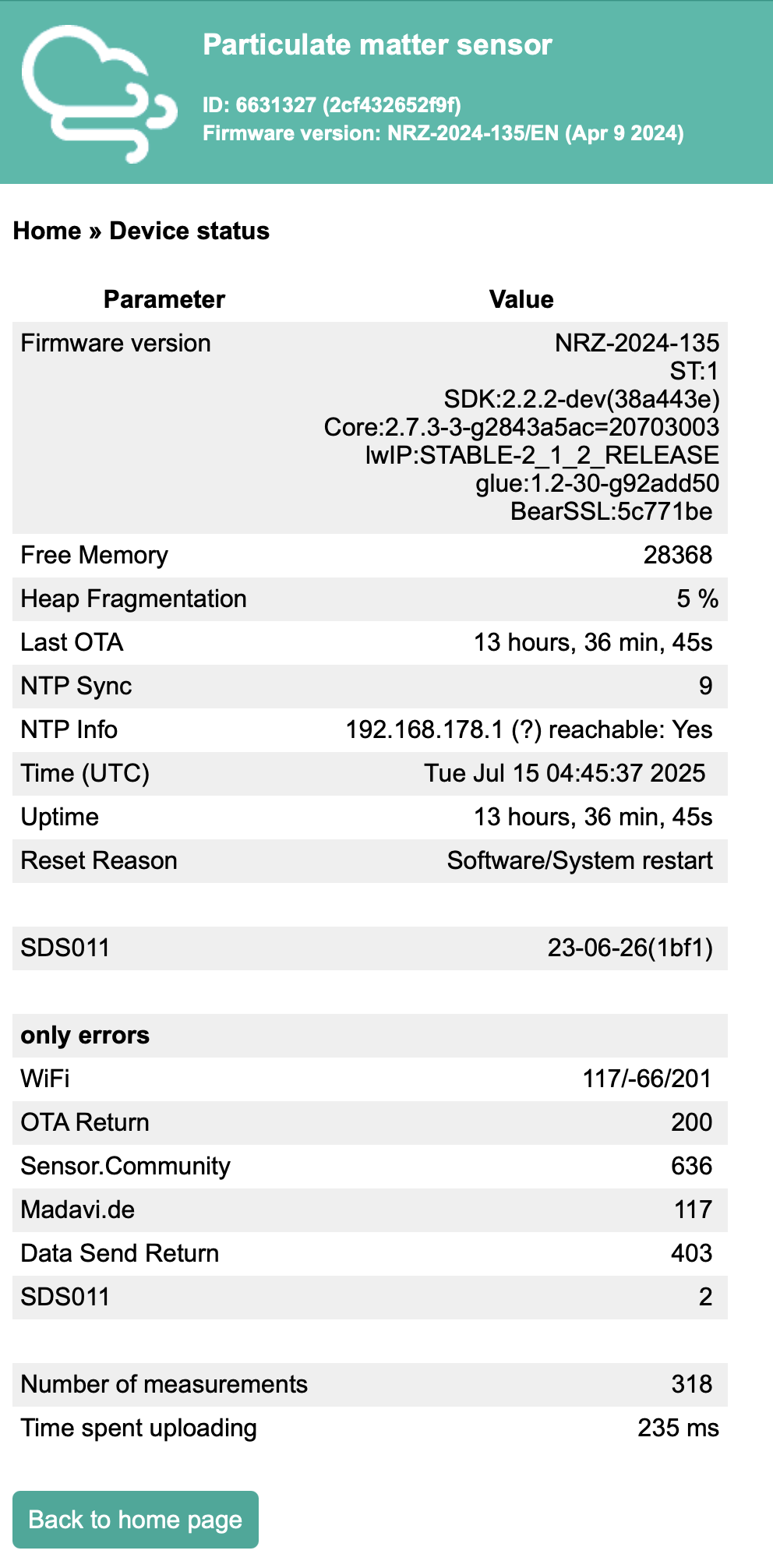

I’m reading the ID from devices.sensor.community when im logged in. I’ll attach my screenshots.

Hello @Till the screenshot shows a chipID 6631327.
I’ve changed the device registration to this chipID.

The registration was for chipID 663127 (see the screenshot of the page at devices.sensor.community).
But the status page of the sensor shows 6631327 as the chipID (screenshot of the status page).
So there was only a missing “3”.
