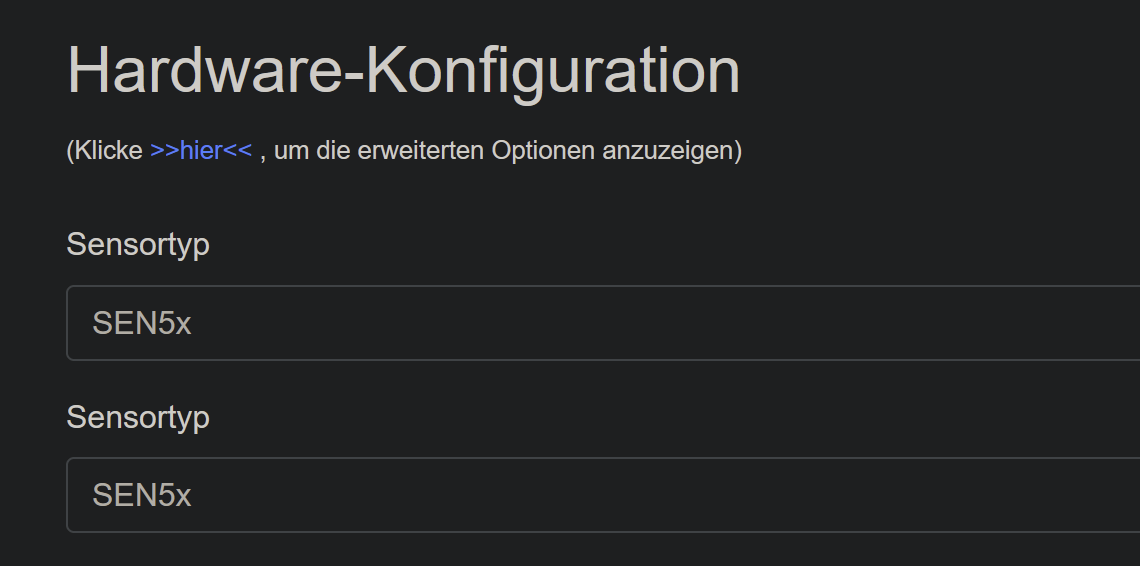

trying to add SEN55 sensor. PM readings work, when I try to add for temp/hum I get “Internal Server Error” after saving
Sensor ID esp8266-9874794

@ricki-z do we support Sensirion SEN5 now ?
You add SEN5x twice
Remove second or select a temp sensor (BME280)
No matter what type one select, this should never throw an 500. Currently not being able to login without 500 ![]()
