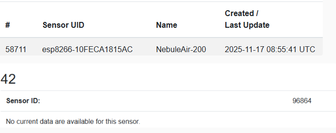

Hi, I have successfully registered the device, keeping the default value for the ‘Sensor type’. Registration went well, but there is no data.Probably the Sensor type is not correct. Any advice on which type shall be used?
I cannot delete the sensor otherwise it is said I won’t be able to re-register it, as example with another sensor type.

You shouldbe able to change the info.
For the NebuleAir, you have to but esp32-…

Hi, with proper settings here and activating dtat transfer from the sensor, the device is now connected and data is available.
