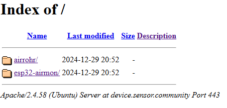

Thanks ricki-z, but I can see only a directory tree there. No setting to open.
Where am I wrong?
Please try https://devices.sensor.community/
Ok, now I have changed position. Thanks very much.
