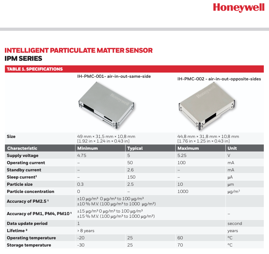

i got this one, to the left.
this is the page with info, from mouser.com
Access to this page has been denied.
so, had anyone success with this ?
i bought the wrong sensor ? i have to do something else ?
Flexibility in outputs – two digital: I2C
and UART, and one analog: PWM

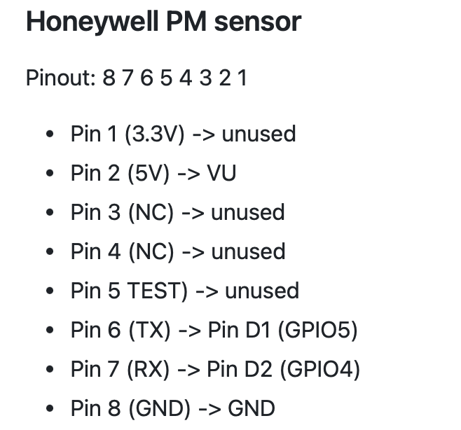

I can t remember which honeywell sensor is in the firmware but it should work the same…

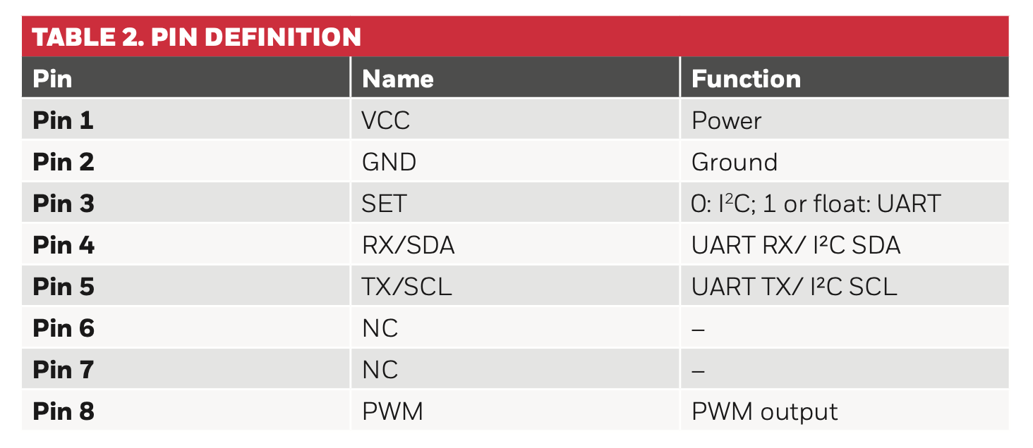

It is not the same pin out:

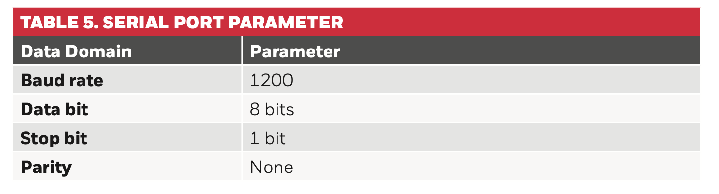

And UART is strange:
You will need to change the firmware…

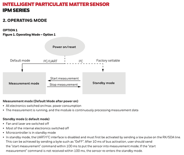

Honeywell Intelligent Particulate Matter sensor (IPM Series).pdf
can you add it in the next version of the firmware ?
there are many interesting things with this sensor:
• Long life of up to 8 years with continuous operation
• Factory calibrated

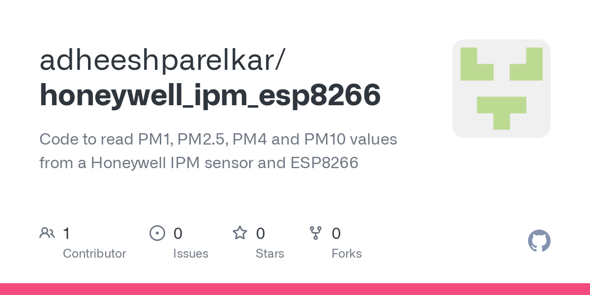

take a look at this also..

But I should succeed with the GitHub rep you sent me.
Code structure is ready but I still have to investigate to reproduce all the functions.
