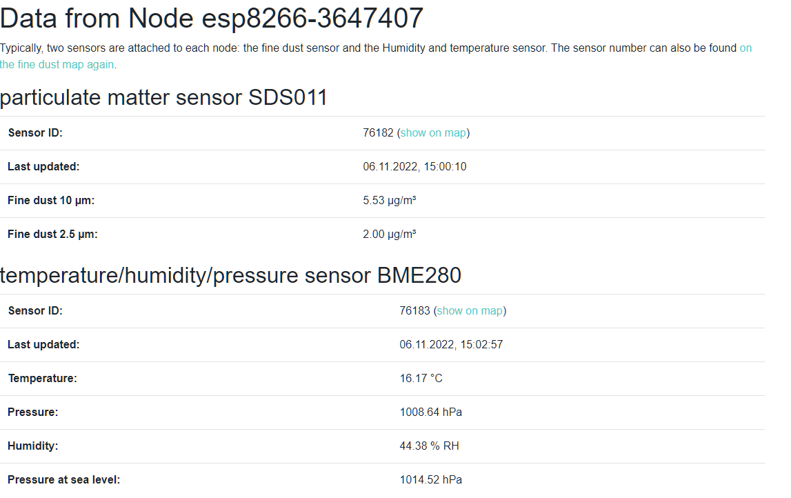

I received my kit from nettigo a couple of days ago.
All sensors are working just fine, but the temperature-data is not transmitted to sensor.community:
Thank you. I did some more looking around and found the setting to change the type of the sensor. For some reason, I expected some kind of auto-detect.
At least, it does now display the correct type of sensor:
