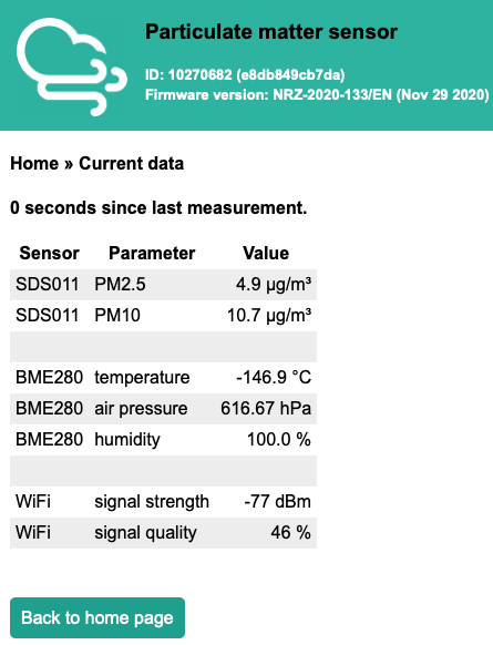

After correcting the connection and the settings, the SDS011 is working fine, but the BME280 delivers values that are a totally off. Temperature -146.9 °C, pressure 616.67 hPa, humidity 100%. Also these values stay constant over time.
