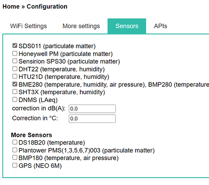

Please send me a picture of the config interface on the sensor. Use the search function of the firmware flasher.
Thanks for the prompt reply. Please see the screenshots below, indeed there is something strange because despite BME is selected on configuration, it shows BMP sensor.

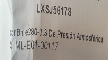

Are you 100% it is a BME ? Some sellers sell some BMP280 while presenting it as a BME280…

Try to set BMP280 in devices.sensor.community. I want to be sure that the API at least receives the data.
And send me also the board ID because I want to check the Grafana dashboard.

You are right the error might be from the seller, I bought the sensor from a local online store, and the title said “BME280 3.3”, but I am now checking the technical specifications and it says BMP 280. I have changed this on devices.sensor.community, and now I can see the temperature and pressure fine on the map. However I am getting different values from api-rrd.madavi.de/grafana thank the ones visualized on sensor.community map. The board ID is ESP 8266-14507506 (a848fadd5df2).
