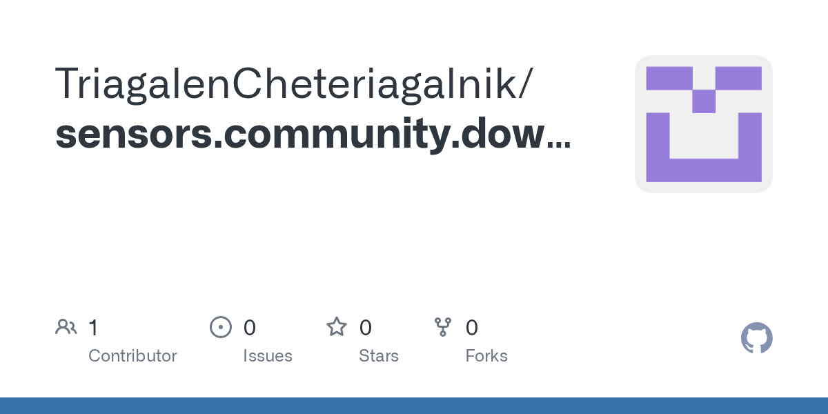

You can find the app here, alongside all the documentation you need to install, configure and use it:
