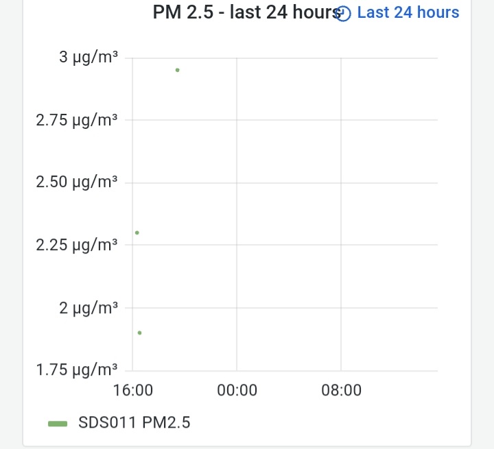

My new air quality Sensor (type esp8266) is not showing the data continuously, but it’s measuring single points in a few hours distance. So the air quality doesn’t look like a graph, but like single dots.
Did I make a mistake?

Change the PSU. You must use a USN`B charger with at least 1.5 A. Check the specs on the case.
Everything is correct. There must be a nother issue…
Have you tried to change the charger, really ? I would say it is 95% the cause of such issue.
Is the range of the WiFi correct?
Can you remove the WPS option on your router if activated.
Did you change the timespan 145s?
Send me Screenshots of the whole config.

I figured out the problem… it was too far away from the router. Now it works perfectly fine!
Indeed the range is important! ![]()
