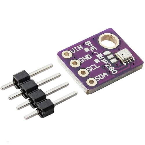

I read that it is recommended to use a 6-pin BME280. Can this 4-pin GY-BME280 also be used instead?
Yes. Some people say that 6pin version is more accurate. Though both should work fine!
It may be true because of additional LDO on 4 pin version. Every LDO is a weak heat source, but in theory it can influence measurements.
Hi, why should it be, that using I2C changes the values? BME280 supports I2C on two addresses and it supports SPI. The Interface-control is by Sofware-interface. Availability of I2C/SPI is through BOB, BME280 is always both. QS is very much dependant on soldering temperature(heating of sensor-element)
