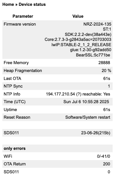

Thanks again for testing! And again no significant difference :frowning: It would have been nice if there was at least one other sensor where this ‘workaround’ would have some effect. One more question: what is the version number of your SDS011 (can be found on the status page, something like 23-06-26(fdff)) ?
this is A

both in my balcony, A is working 6 months, B is working 2.
